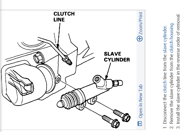

i feel like im getting a low clutch. i have to step on the clutch pedal "to the metal" in order for me to switch gears. and i also changed my battery a month ago and battery is dead. i dont know whats goin on with my car..

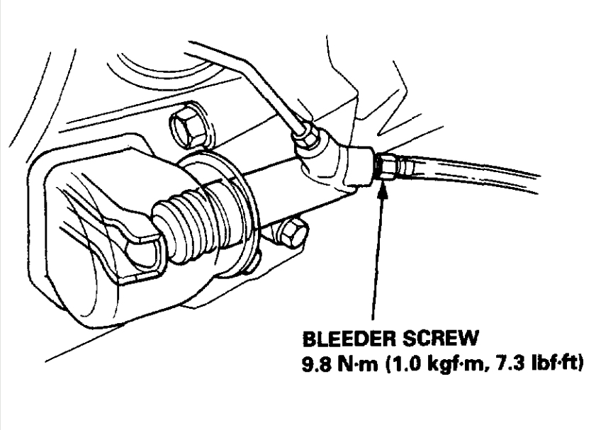

bleed the clutch slave/servo then adjust the free play and pedal height.

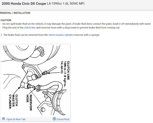

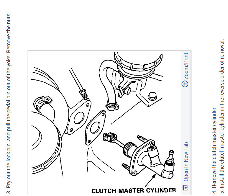

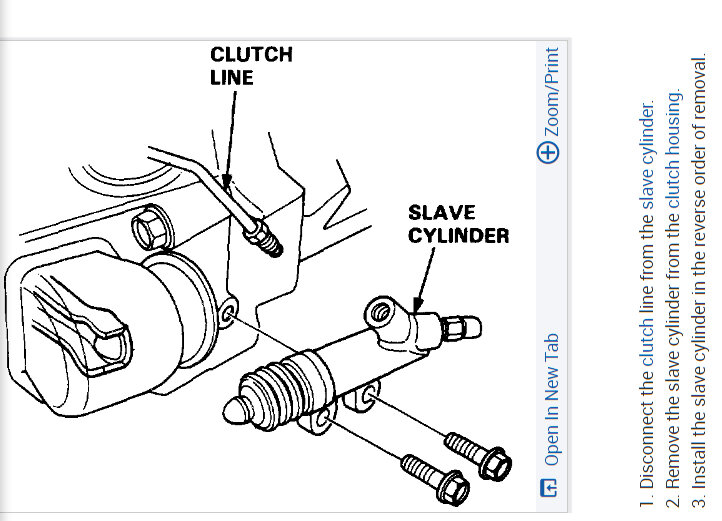

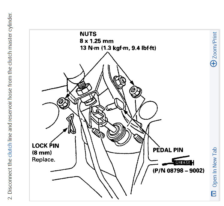

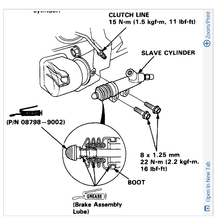

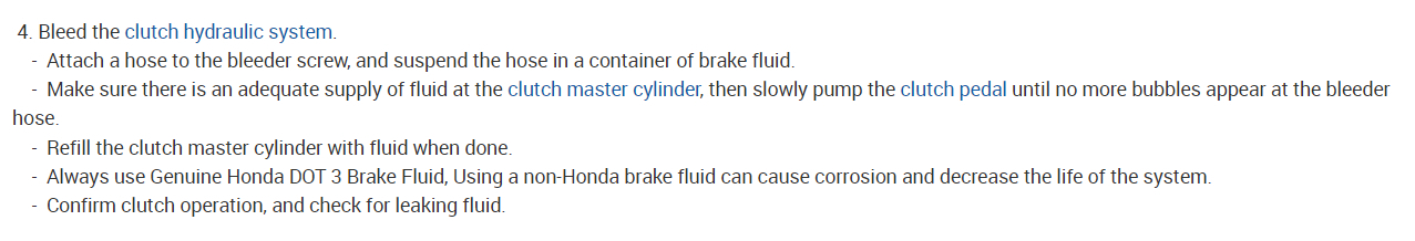

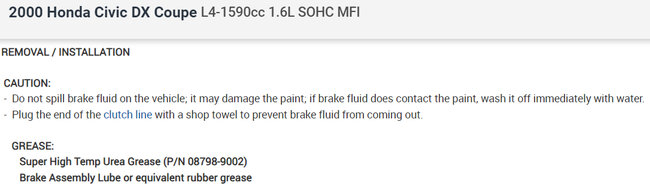

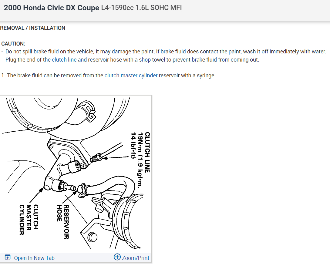

Chances are the clutch master and slave cylinder needs to be replaced and the system wbled, here is how the job is done. Check out the images (below). Please let us know what happens.
