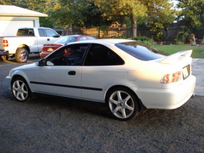

Thanx for the info. I was told that my "speedometer cable" wasn't shot and since it still kind of worked it just needs to be "tightened" haha... oh wow. I'm a chick that (obviously) knows JACK about cars!
https://images.2carpros.com/forum/automotive_pictures/399849__2.jpg
There's my excuse :) Thanx again!!
