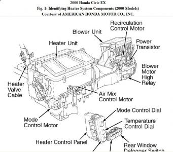

Is it a simple repair to replace the AC/Heater Fan on this 2000 Honda Civic EX?

Hi Ric Miner, Yes, it is rather straight forward and simple. Removal & Installation Disconnect negative battery cable. If necessary, remove glove box and glove box frame. Disconnect electrical connectors as necessary. Remove 3 screws securing blower motor to blower unit. Remove blower motor. To install, reverse removal procedure.
