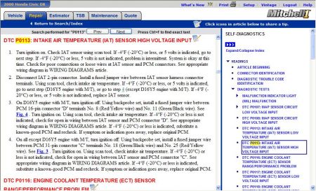

My Daughters car has this and two other codes read from the OBD computer, P0505 I understand and P0420 was her aftermarket Air-Cleaner not having a heat riser, but the P0113 has me baffled as to what is the cuase and remedy? Any help is much appreciated!

Hi Tim, P0113 = IAT (Intake Air Temperture) sensor circuit high voltage input.
https://images.2carpros.com/forum/automotive_pictures/192750_Civic2000P0113IAT_1.jpg
