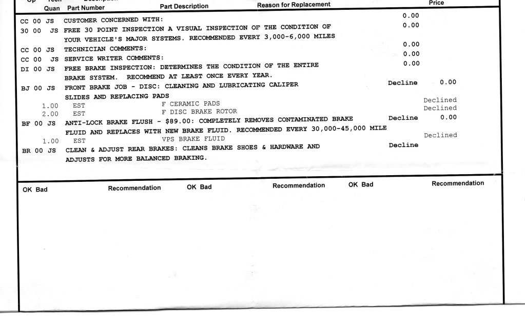

I took my car to a mechanic.They gave me a estimate .
https://www.2carpros.com/images/question_images/199273/original.jpg
Can some one tell me which one I need to do first ?
Is there any thing I can do it by myself? My mechanic said it will take about $500 for all of the problem . lol

If it's coming from the back then it's probably your rear brake shoes(Are you sure that's really where the sound is coming from). According to this invoice, are they just recommending cleaning and adjusting of the back shoes? It looks like they want to replace of the front pads and rotors? I'm surprised that they didn't find anything wrong with the back shoes, that's why I mention to be sure of where the sound is coming from.
The metal on metal sound while you foot is not on the brake is a good sign that the pads are running out of padding. The fact that the squealing is happen after you put the brakes on is a sign that the pad is completely gone and is now grinding groves into your rotor, hence the new rotors they put into the estimate. If you haven't done too much damage to the rotor they may be able to grind out the grooves.
As far as the brake fluid flush goes, it don't know how that would contribute to the noises your hearing. Unless the fluid is really black and grainy, I don't know how important it is.
