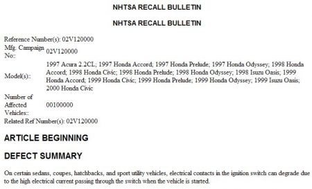

I started my civic this morning and it seemed as though the battery really had to grunt to turn it over, yes it is december but it was very mild today, much milder than the last 2 weeks when it had no problems. I started it again and at first the battery seemed like it wasn't going to turn the engine over and then turned once and fired right away. So it appeared as though the battery was running low. Next time I tried to start it, it wouldn't even turn over. So I check the battery with my voltmeter and it is reading 12.25 on the terminals and 12.25 on the battery cables.
The previous owner (who is a friend of mine) told me that he had replaced the ignition module twice in the past. It sounds like the same scenario that he described to me. Is this a common problem and if so what might cause it to become a chronic problem. Something must be causing this?
Any ideas?

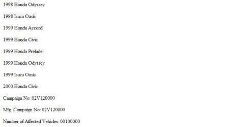

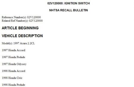

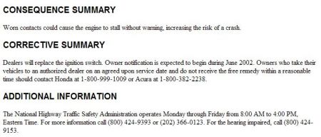

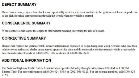

There is a recall out for the 2000 Honda Civic electrical ignition switch. Below is information on the recall. This recall means that you may qualify for free repairs at your local Honda dealer. Give them a call and give them the ref. number for the recall and also your VIN number to see if you qualify for free repairs of this component. I believe this will solve your problem, and is probably why the previous owner had to change the module twice in the past. Let me know the results .
