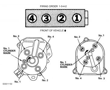

In reference to your reply to my question. My Haynes Repair Manual and a web site both indicated that the firing order is 1-2-3-4, not 1-3-4-2. Could you please verify?
In the meantime, I will try 1-3-4-2 to see if it runs any better.

It should run better, I dont recall ever seeing a 4 cyl that fires 1,2,3,4 . 1 and 4 should be across from each other on the dist cap

You were absolutely correct. I mis read the diagram I was looking at. Your's was simpler to understand.
