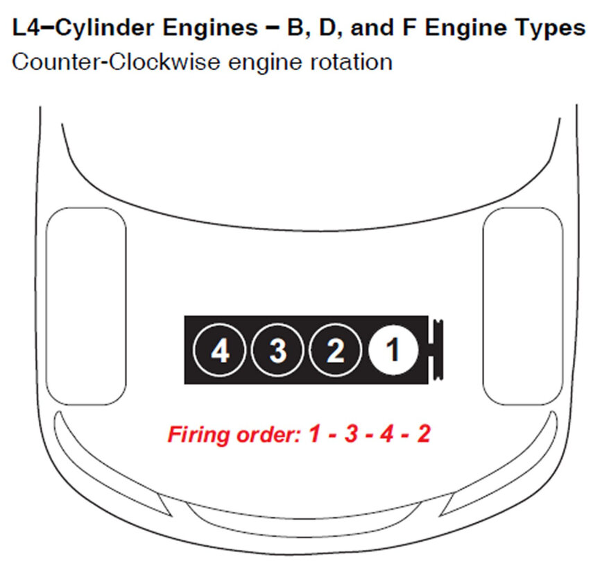

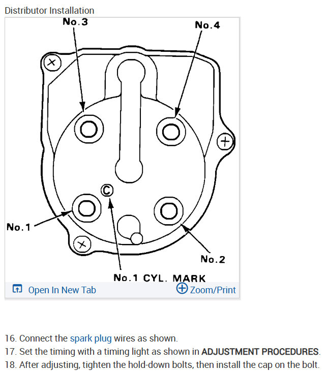

whats the firing order. i mixed the cables up
Dec 16, 2007 at 8:24 AM
MHPAUTOS
  • 31,937 POSTS
Hi there,
the firing order is 1.3.4.2. No1 on the distributer is looking from the top R/H front terminal at about 5 O"Clock and turning in a clockwise direction.
Mark (mhpautos)
Dec 16, 2007 at 10:13 AM
  • 55,684 POSTS
Here is the firing order and how the spark plug wires go on the distributor cap. Check out the images (below). Let us know if you need anything else.
