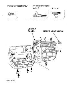

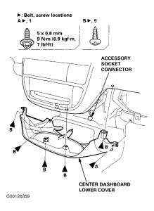

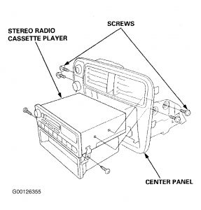

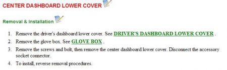

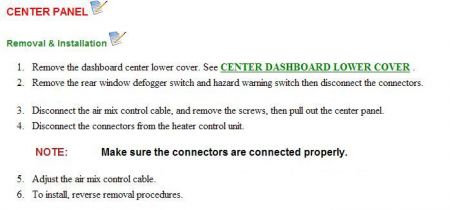

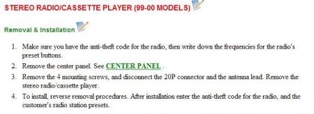

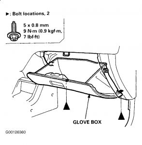

How do I remove the dash for a 1999 Honda Civic to install a new stereo from Walmart? Christmas present.
Please include pictures if possible.

https://images.2carpros.com/forum/automotive_pictures/261618_Noname_1361.jpg
