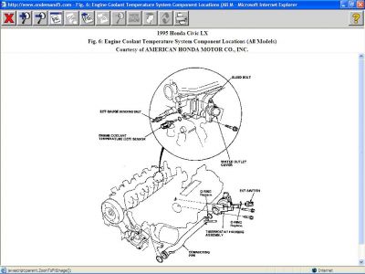

SLUG2FACE
my radiator fan will not work, making my car overheat.its not leaking, i put a brand new radiator and water pump and the three belts that are on the right side of the motor, i put all three new, i also put a new thermostat, i dont know how to check this , please help with this question
Aug 9, 2019 at 10:49 AM (Merged)
BRUCE HUNT
  • 3,754 POSTS
You can test the radiator fan by wiring it direct to the battery. I would suspect that it is fine and the issue will be with the temp sensor that activates the fan. Also, since the work was done it might be nice to check the system to make sure the air is out of it. Purge the air from the system with the engine warm and running by cracking open a bleeder.
SLUG2FACE
Where is the bleeder and the temp sensor located? Thanx I feel better that. U guys are helping me.
BRUCE HUNT
  • 3,754 POSTS
Follow the big radiator hoses and you will find a little nipple that takes I think an 8mm wrench. If the fan runs one of these sensors shown is possibly bad. I wouldn't just rush out and replace them. Bleed the system first and then if you have and know how to work an ohm meter I can tell you how to test the sensors.
https://images.2carpros.com/forum/automotive_pictures/10316_95_1.jpg
