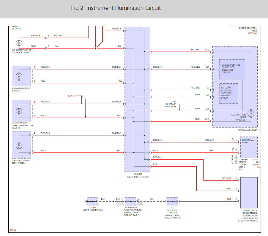

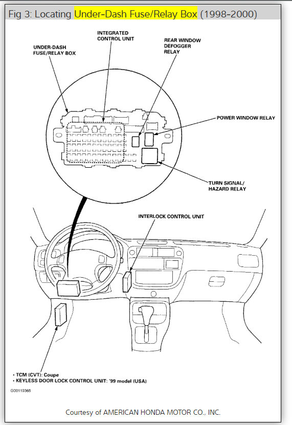

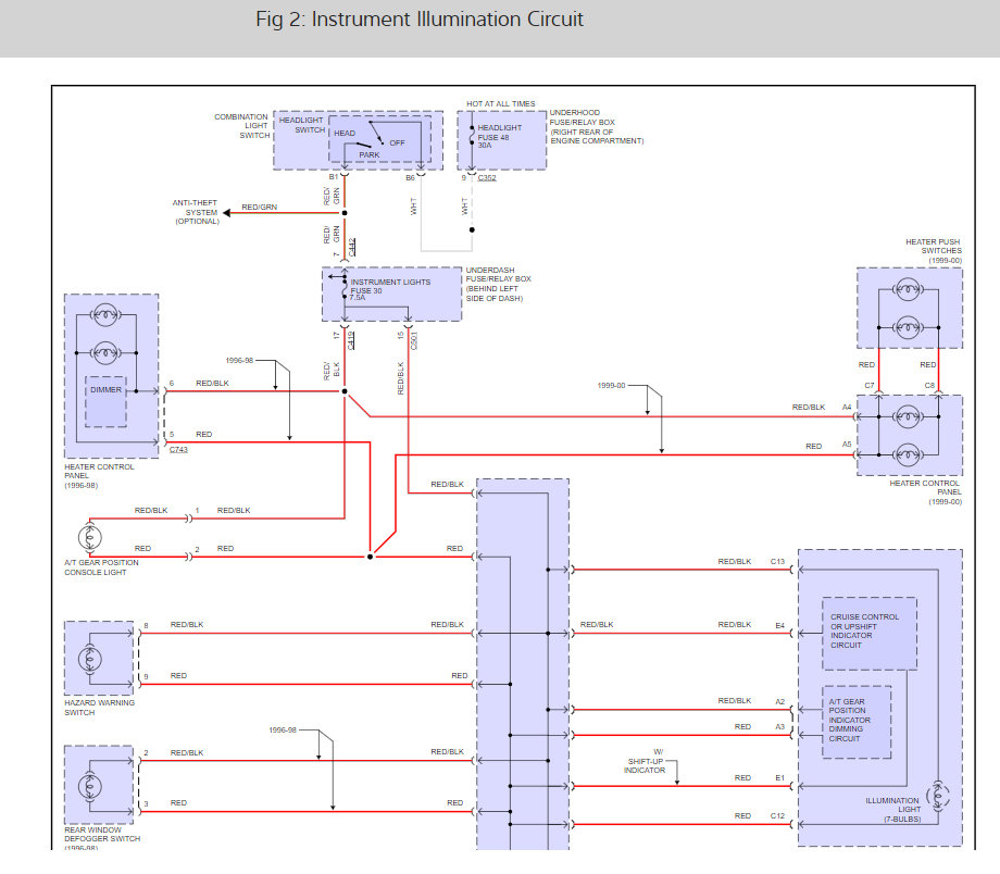

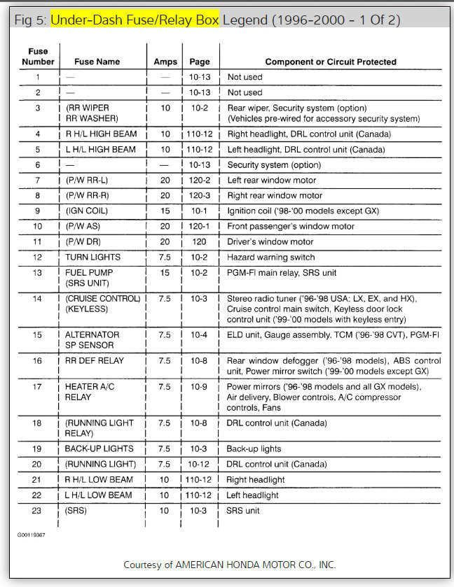

My instrument/dash lights went out when I put in a new stereo. I checked the fuses and they are fine. What could be the problem and how do I fix it?
Jul 25, 2009 at 11:34 AM
KHLOW2008
  • 41,814 POSTS
Hi michiv,

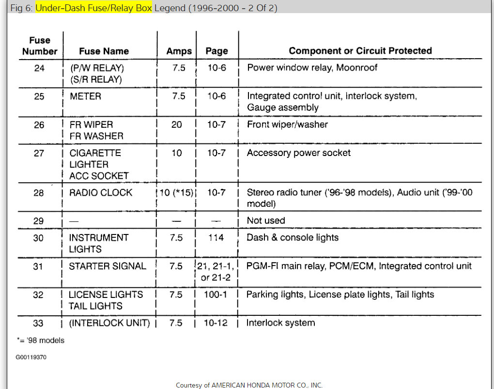

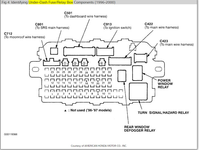

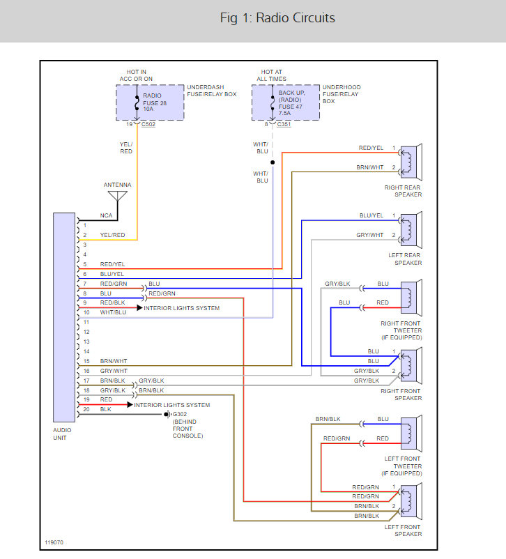

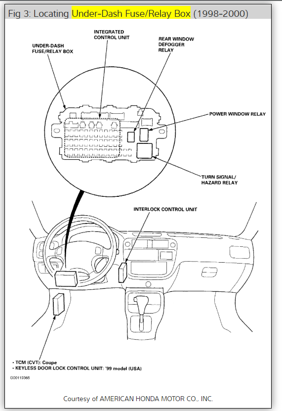

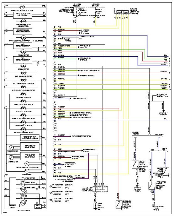

It sounds like you lost power to fuse #30 in the under dash fuse panel here is a guide to help you test with the fuse location and wiring diagrams for the radio and instrument cluster light so you can see how it works.
Check out the diagrams (Below). Please let us know what you find. We are interested to see what it is.

Thanks for this post I found a bad connection at the fuse causing the problem. I love this site.

The OEM radio has a system whereby the lighting uses 2 wires and with an after market radio, the system has been disrupted therefore the interior illuminations lights would not work corectly.

Next I would unplug the radio, then see if the lights work. If they do, chances are the dash light wire got inadvertently used as a ground wire. There is a wire in the original radio's connector for the tail lights and another one for the dash lights. The tail light wire tells the radio to dim the display when the head lights are on. The dash light wire tells the display how much to dim. Both of those wires measure very low resistance to ground because of all the bulbs on those circuits. That's why many people confuse them for ground wires.

The dash lights are connected to the taillights. A short in system has occurred and you need to locate the source.
If there is any impact damages, check around the area for damagd wire harnesses that might be grounded.
Check for bad bulbs or sockets.

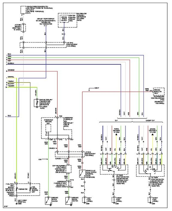

DRCRANKNWRENCH
  • 3,380 POSTS
I am giving you the wiring diagrams for the instrument panels. They are in 2 parts. Use them to look for short or bad ground.

Test the light switch. When light is switched on, voltage must be present Light switch connecter terminal # 1 ( Red/Green ) wire and Fuse # 8 in fusebox. You need a test lamp to test by backprobing the terminals.
