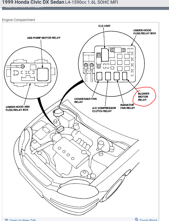

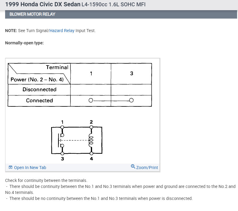

I have installed a radio into a 99 honda civic equipped with cassette player also,after the installation the a/c blower fan did not work properly The connection is not lose on the a/c controls.The fuse is also not blown.maybe a resistor?Please help Thank you very much

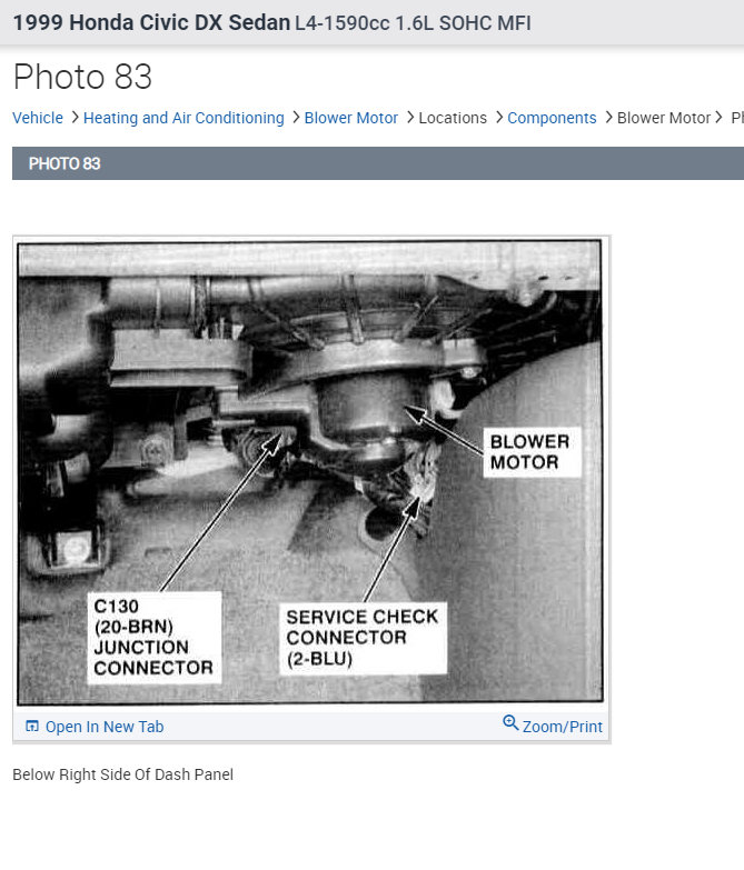

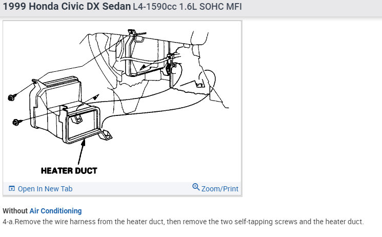

Inoperative blower fan can be due to a bad blower relay, wiring issue or a bad resistor or the motor itself.
The blower relay is located in the under-hood fuse box (see diagram below).
Check for any corrosion or burnt pin(s).

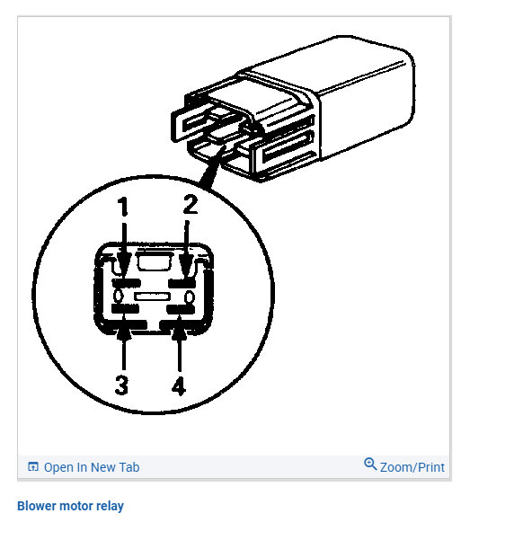

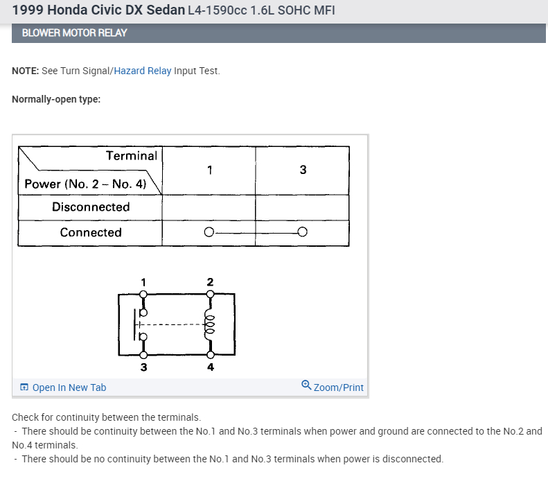

This relay can also be tested:
If the relay is good and there is power to the blower motor, then the issue is likely a bad blower motor.
https://www.2carpros.com/articles/blower-fan-motor-works-on-high-speed-only
You also want to make sure that none of the wire got loose/disconnected or pinched during the radio install.
