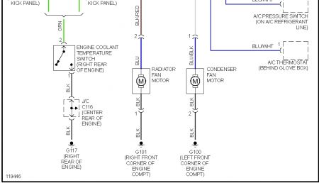

My engine cooling fan fails to work. I jumped the fan motor and it works fine, I tested the relay and it seemed fine but switched it with the relay on the condenser fan (which works fine and the relay was the same part #) and the condenser fan worked with both relays. The fuse is fine. I replaced the ECT sensor on the thermostat housing, drained and flushed the coolant and even went so far as to change the water pump. It still doesn't come on even though I drove the vehicle and the coolant should have gotten hot enough to close the ECT circut. I put a jumper on the connector that attaches to the ECT sensor and the fan comes on. My best guess is that the brand new ECT sensor is bad. What do you think?

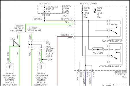

the PCM (powertrain control module) is what tells the ECT sensor to turn the fan on. i would be looking towards a replacement PCM over replacing the ECT sensor for a second time. i have posted the wiring circuit of your vehicle's cooling fan below ..
https://images.2carpros.com/forum/automotive_pictures/261618_Noname_2581.jpg
https://images.2carpros.com/forum/automotive_pictures/261618_Noname2_837.jpg

What you've changed is the thermo switch.test for switch contact.it should be open when coolant is cold and it should close when the coolant is hot.if its working fine,check and clean the connector contacts.
