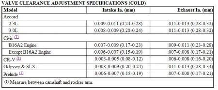

Thanks again. One more question today. Could you give me the valve clearances? I am going to install a new timing belt tomorrow and that would be a perfect time to check that while we have it in the shop. Thanks again.
Jun 4, 2009 at 2:41 AM
KHLOW2008
  • 41,812 POSTS
This is a convenient time to do it. Here are the specs.
https://images.2carpros.com/forum/automotive_pictures/192750_ValveClearanceSped99Honda_1.jpg
