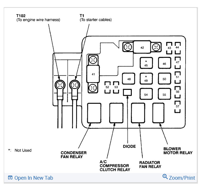

What could cause the 80 amp fuse to blow? We have taken the alternator out and had it checked and it was fine. Please help!

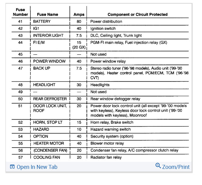

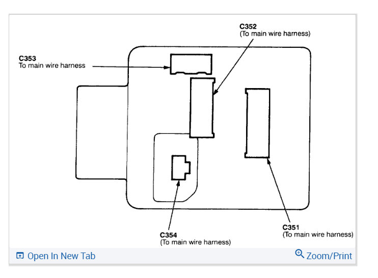

There must be some kind of main short to the fuse panel or starter. Here are some diagrams that can help. I would unplug the ignition switch to see if it stops, also check down by the starter to see if there is a problem there.
