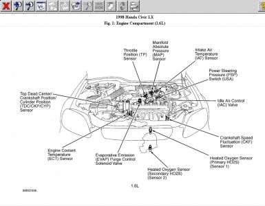

Hello. I am trying to locate an Idle air control valve on my 1998 Honda civic LX model 1.6l 4 cyl. Is it next to the starter? How many hoses runs from it? Do you have any pictures of it. Thanks.

No, its attached to the throttle body, should just be a two wire plug going to it for power and signal, here is a diagram
