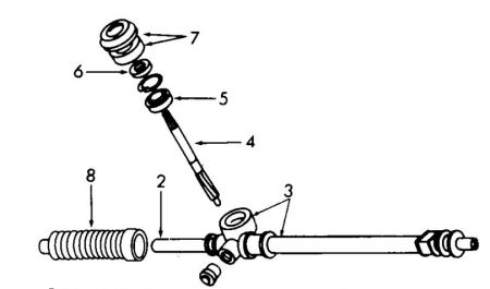

my car failed a safety inspection- the reason stated is "bellows needs to be replaced". What does that mean and how much should I expect to pay for the repair?

Hi Ilana, The bellows mentioned should be the steering rack bellow (boot). Item # 8 in diagram
https://images.2carpros.com/forum/automotive_pictures/192750_Steering98Civic_1.jpg
The parts cost per piece is $ 17.68 for power steering, 2 pieces per vehicle. Manual steering parts cost is $21.43. I do not have the labor time available so you should enquire at your local shop.
