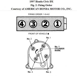

Car won't start i replaced plugs, wires, distributor,cap and coil but I'm not sure I placed the wires correctly fron the plugs to the distributor
