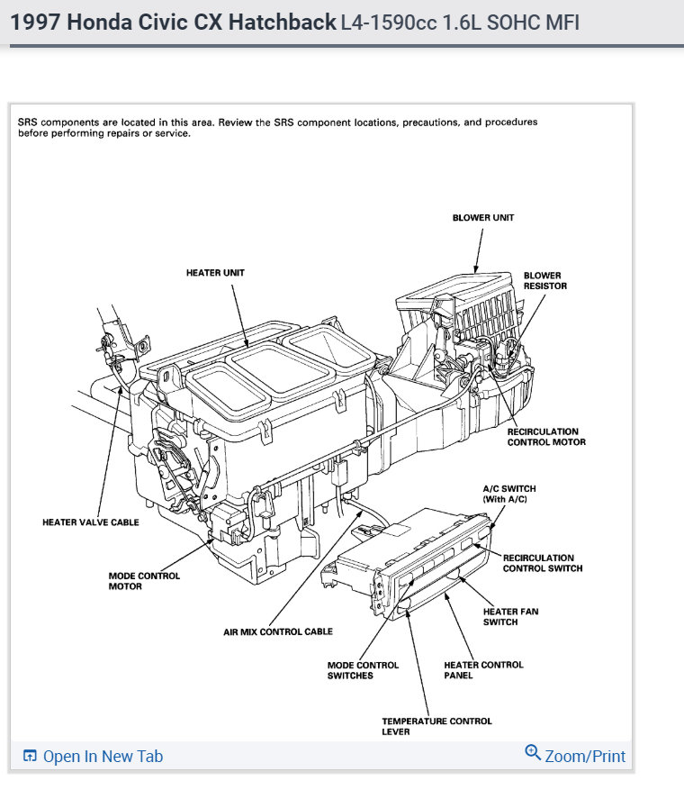

the first two speeds on my A/C fan switch doesnt work, the last two speeds (High) does work. is the problem with the fan, switch or does the fan have seperate fuses for the first two speeds?

This is a problem with the blower motor resistor. This is located behind the glovebox and is no more than a $30 part.

i kinda have the same problem but my blower motor never changes speed when i put it on 4 feels like its on 1

It sounds like the blower motor resistor has gone out lets remove it to inspect for burn marks, here is the location. Check out the diagrams (Below). Please let us know what you find.
