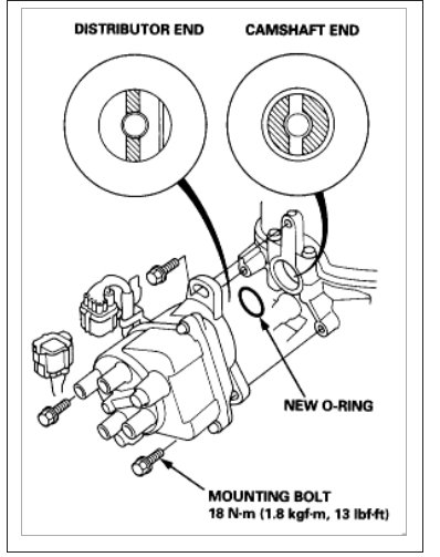

My check engine light is on. I am getting error code P1336 and P1337. Please suggest how to get rid of it.

This is a crankshaft position sensor issue which is inside the distributor I would just get a rebuild one from Amazon for 61.00

Codes for crankshaft sensor failure
