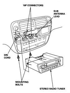

1996 Honda Civic stereo removeal
ROLANDOIBARRASR
Interior problem
1996 Honda Civic Front Wheel Drive Automatic 15600 miles
how to remove a stereo
Jan 16, 2010 at 8:29 PM
  • 75,988 POSTS
Notes Remove the center dashboard lower cover. Remove the two mounting bolts, and pull the stereo radio tuner out.
https://images.2carpros.com/forum/automotive_pictures/12900_radio_5.jpg
Disconnect the 16P connectors, sub antenna lead and DIN cord (with cassette player), then remove the stereo radio tuner.
