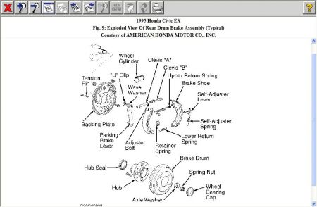

i'm trying to put my rear brake shoes back together help me

Hi mackusr7, I have here and exploded view of the brakes, hope it helps.
