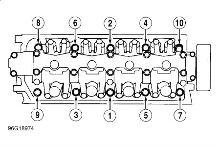

head gasked torque especifications

I will need your engine code to get you the correct torque specs.

The engine is a 1.6 four cylinder, not v-tech, build in Canada.

Hi there, see pic and text for head torques. mark (mhpautos)

Thank you very much for your service, we do have the torque wrench, we just need to know the pounds of torque.
How many pounds of torque do I need to tiding the head gasked bults.

The figurers in the chart are the torques, in steps, 3 steps to 49 Ft /Lb then re test all to 49 Ft/Lb
