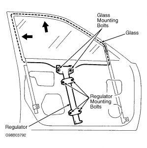

How to replace electrical window assembly

Hi Itsmevato, Remove the door panel and lower the door glass till the door glass mount bolts are aligned with the service hole. Remove the bolts. Disconnect the motor wire connector. Remove the regulator and motor ( not shown) mounting bolts. Regulator and motor assy can now be removed.
