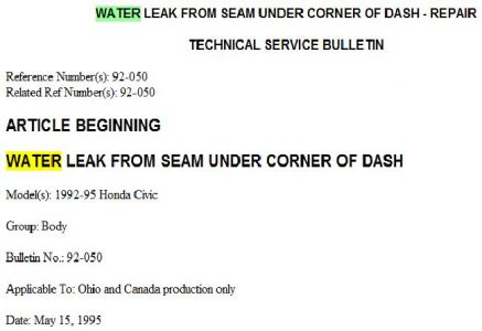

1995 Honda Civic water leak
1995 HONDA CIVIC
165,000 MILES • 4 CYL • 2WD • AUTOMATIC
NICCOI

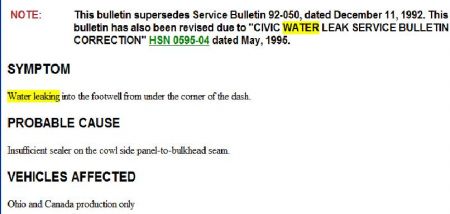

After a hard rain and the car has been sitting there carpet on the driver's side front will be soaked on the left side. There are now visible leaks from the door, or the window. The carpet around the well of the floor is dry. No moisture up by the pedals either. It actually looks like the water is coming up from under the car. Any suggestions?
Apr 30, 2009 at 6:10 AM
F4I_GUY
  • 3,302 POSTS
https://images.2carpros.com/forum/automotive_pictures/276698_TSB_water_1_1.jpg
https://images.2carpros.com/forum/automotive_pictures/276698_tsb_water_2_1.jpg
If you think this TSB applies to you, I can e-mail you the full TSB.
