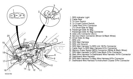

Hello everyone i have a 95 civic and the srs light stays on and idk how to get it to tern off after the 6 seconds and i was wondering witch loop you were talking about if it is in the dash or some were else

RETRIEVING DTCS Turn ignition off. Connect SCS Service Connector (07PAZ-001010A) to service check connector. Turn ignition on. SRS indicator light will come on for about 6 seconds, and then go off for 2 seconds. After 2 seconds, SRS indicator light will: Quickly flash on and off (no DTCs are set in memory), or Begin flashing DTCs
