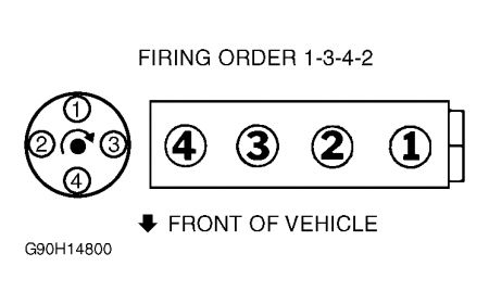

the spark plugs where taken out an i need to now how they go bak in the propper way or see a diagram
Oct 21, 2010 at 4:56 AM
DOCFIXIT
Experienced Mechanic
18,828 POSTS
Guessing need firing order?
