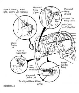

fuel pump is probably not getting power. did you disconnect the battery when replacing the tank? check the fuses and the fuel pump relay.

Wow, I'm impressed with the quick response. Can you tell me where the fuel relay pump is located on the 95 honda civic?

behind the left side of the dash, near the top of the kick panel. it might be labeled PGM-FI Main Relay .

Sorry, but can you tell me where the kick panel is located? Us small time mechanics need all the help we can get. Thanks.

the kick panel is the plastic trim where your left leg will normally be near while sitting in the driver seat

I've looked all over where you said and there isn't any plastic trim and I do not see a panel as it is wide open. Any other suggestions? Thanks for all your help so far.

see if this helps...
https://images.2carpros.com/forum/automotive_pictures/261618_Graphic_210.jpg
