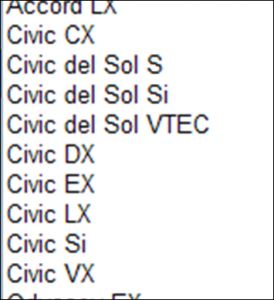

Hello - To better assist you I have attached the choices of a Honda Civic. Please let me know your model and also the size of your engine in liter.
https://images.2carpros.com/forum/automotive_pictures/248015_1_150.jpg
