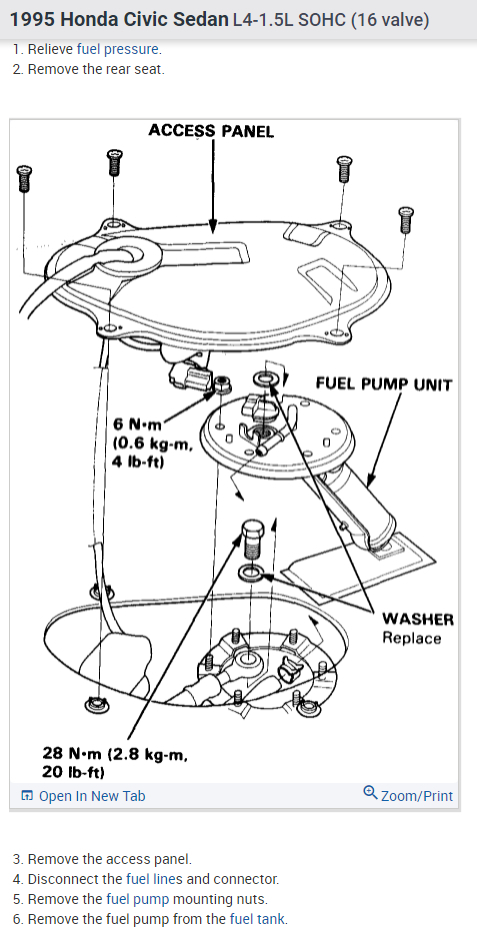

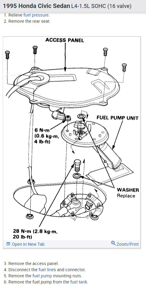

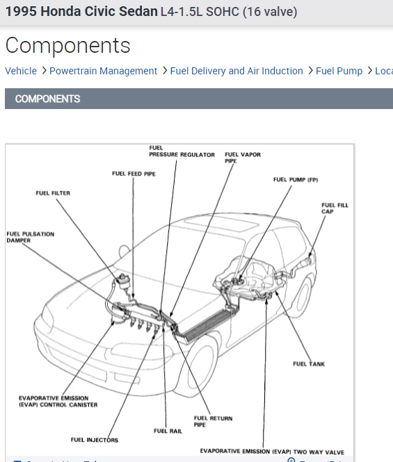

How to remove fuel pump from fuel tank?
Tuesday, February 16th, 2010 AT 11:21 AM
SQM
  • 6,383 POSTS

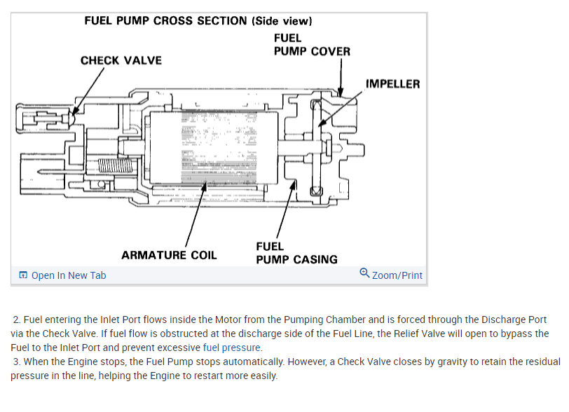

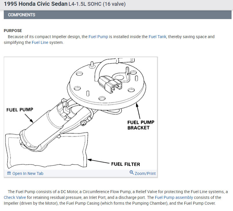

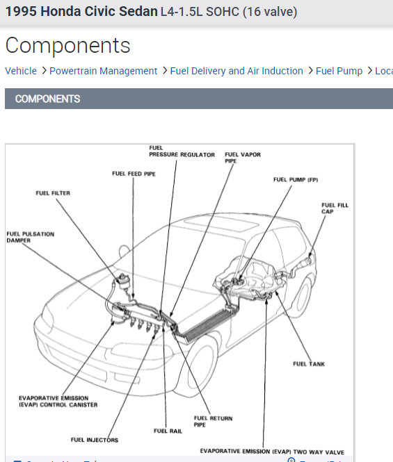

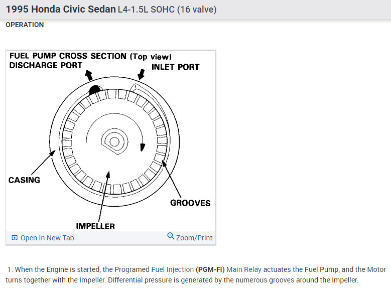

When replacing the fuel pump on this vehicle you do not have to drop the fuel tank.
In order to replace the fuel pump, you will have to remove the rear seats.
There is an access panel that will allow you to get to the fuel pump.
Simply disconnect the fuel lines, the electrical connector and the mounting bolts. T
he pump will come out.
https://www.2carpros.com/articles/how-a-fuel-pump-works
https://www.2carpros.com/articles/how-to-replace-an-electric-fuel-pump
