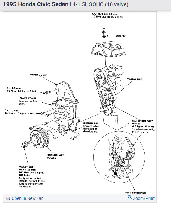

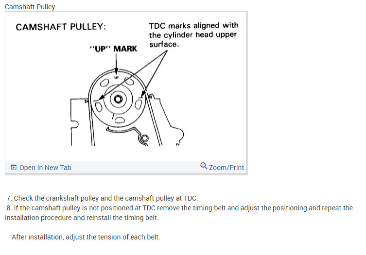

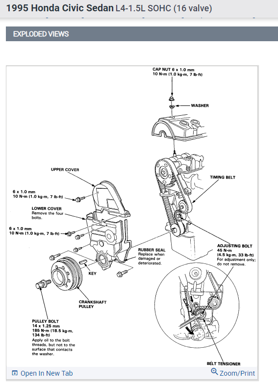

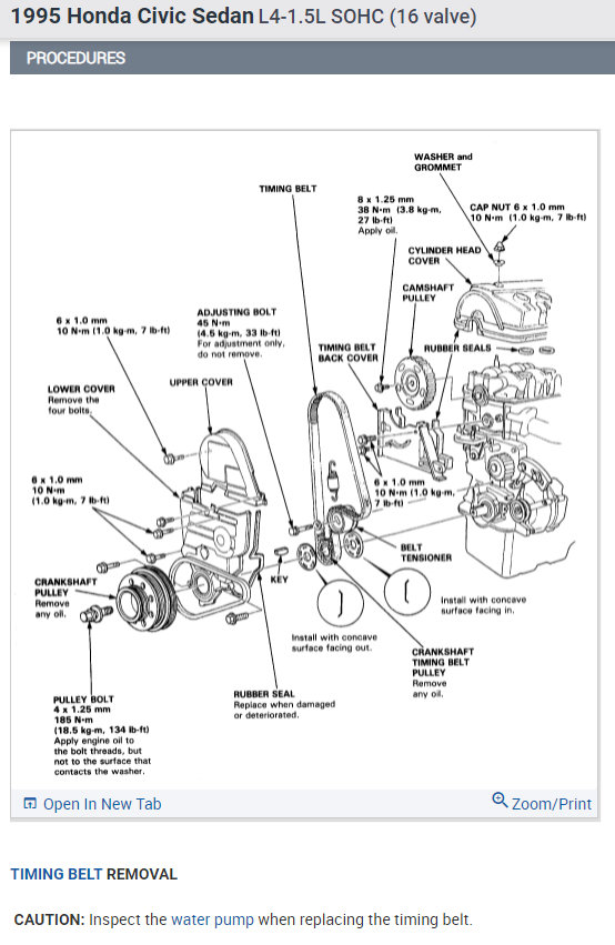

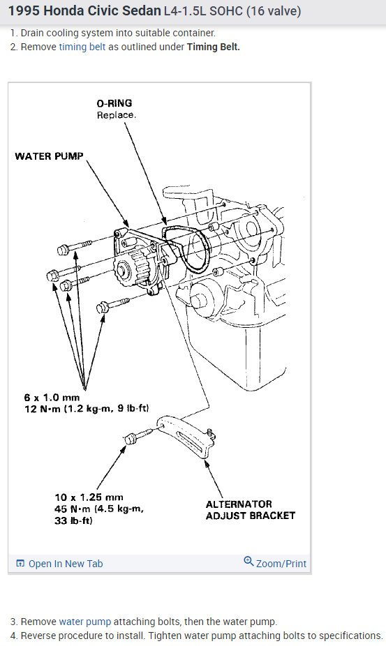

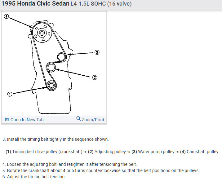

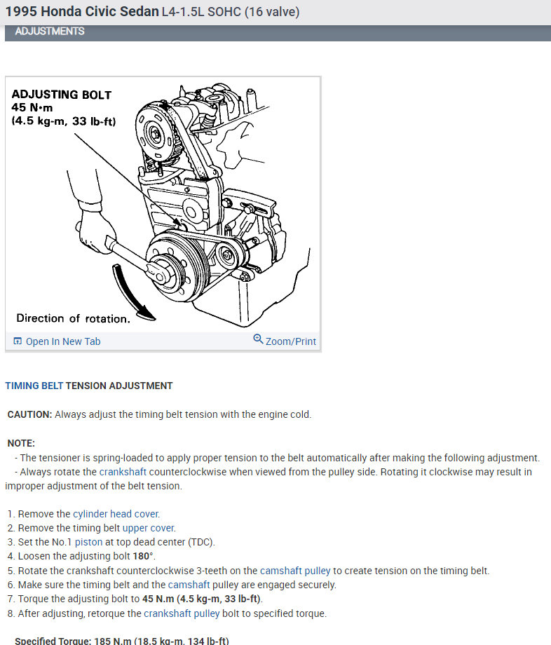

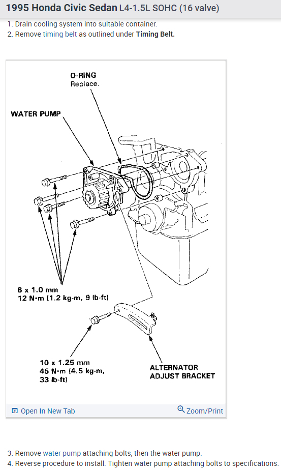

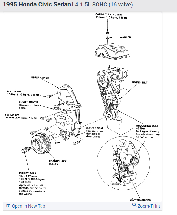

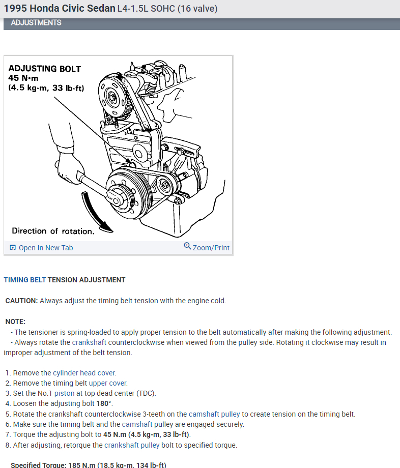

On this vehicle in order to replace the pump, the timing belt needs to be removed. It is recommended to change the timing belt if you are changing the water pump and vice versa.
https://www.2carpros.com/articles/water-pump
https://www.2carpros.com/articles/symptoms-of-a-bad-water-pump
https://www.2carpros.com/articles/water-pump-replacement
