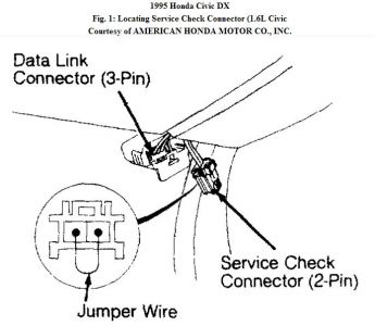

Hi I bought a 95 civic bought 4 months ago it has been driving fine until bout a week ago it has been acting up out of nowhere I was driving then all the sudden the check engine light came on then it went away then the car just died sometime its takes awhile to start back up any idea? I only changed so far the spark plugs and fuel filter

Hi andyboy123,
Have you tried retrieving the troube code?
Bridge the SCS and turn ignition switch ON. Count the blinking of the CEL to get the code.
https://www.2carpros.com/forum/automotive_pictures/192750_SCS95Civic_1.jpg

Yes actually I did that yesterday the check engine light stayed on and the srs light was the one that kept blinking I left it for about 2 mins and and nothing happend check engine light just stayed on wasn't blinking at all

I am having difficulty understanding your explanation.
When the alternator fails, the CEL would not be staying ON when ignition switch is turned ON. Only the charge indicator light would be staying ON.
When the CEL stays on, either the ECU is faulty or one of the sensors has been detected to be faulty or disconnected. When ignition switch is turned ON, the CEL would blip before staying ON.
Are you able to start the vehicle now?
Did you retrieve the trouble code?
Did the engine overheated when it stalled?
