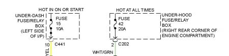

it wont go in gear unless u take the key and putt it in the shift lock and my tac is not working

Start with checking the 2 fuses as indicated in the pic.
