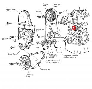

I need to kno how to change the waterpump on my 1994 honda civic. This shops around here are trying to charge me 1000 dolloar to fix my waterpump.

You will definitely need to consult a service manual, the timing belt will have to be removed.

How are you in doing timing belt s
u need to remove the belt to get to the pump
get another estimate
way tomuch
https://www.2carpros.com/forum/automotive_pictures/99387_honda_15_1.jpg
red is the water pump
good luck
