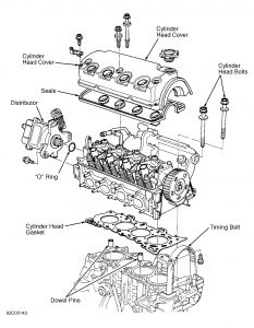

Can you tell me the torque specs. On 94 1.5 head bolts and intake manifold?

It looks like there are several engines used in the Civic DX. The engine serial number is located on exhaust side of engine block, below cylinder head near bellhousing. The first 5 characters of engine serial number identify engine type. Please take note of your serial number before following instructions below, although the tightening sequence remains the same, the torque specs are different for each engine type in the Civic DX.
Here is a video to help you see how to use a torque wrench.
https://youtu.be/juOClONIWeY
SOHC ENGINES for Civic DX
Cylinder Head Bolt Specs.:
Engine Type D15B7 & D15B8 :
Stage 1 - 22 ft lbs (30 Nm)
Stage 2 - 48 ft lbs (65 Nm)
Engine Type D15Z1 & D16Z6
Stage 2 - 53 ft lbs (73 Nm)
Cylinder Head Bolt Tightening Sequence
https://www.2carpros.com/forum/automotive_pictures/261618_Graphic_12.jpg
Intake Manifold-To-Cylinder Head Nut Specs.:
17 ft lbs (23 Nm)
Cheers

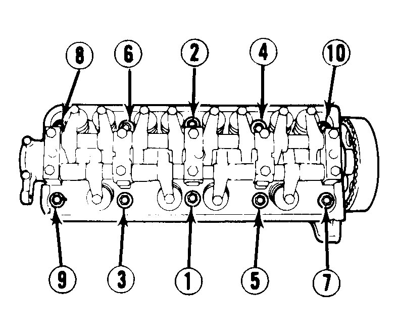

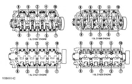

What is the head bolt torque sequece and ft/lbs of torque on a 93 hond civic 1.5l
+5
Saturday, November 17th, 2018 AT 11:35 AM (Merged)
OBXAUTOMEDIC
  • 3,711 POSTS
D15B7 and D15B8 Engines
Stage 1 = 22 foot pounds
Stage 2 = 48 foot pounds
D15Z1 and D16Z6 Engines
Stage 2 = 53 foot pounds
https://www.2carpros.com/forum/automotive_pictures/188069_93civicheadtorqseq15L_1.jpg

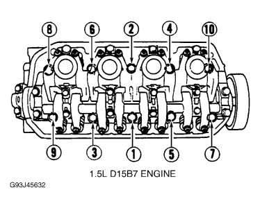

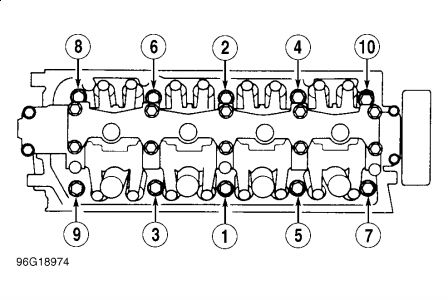

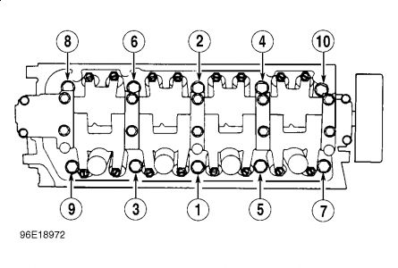

Hi I was wondering what the head bolt sequence for a 95 Honda civic would be?
+2
Sunday, February 3rd, 2019 AT 8:37 AM (Merged)
BMRFIXIT
  • 19,053 POSTS
1.5l engine
https://www.2carpros.com/forum/automotive_pictures/99387_Graphic1_618.jpg
1.6VETc
https://www.2carpros.com/forum/automotive_pictures/99387_Graphic2_294.jpg
+8

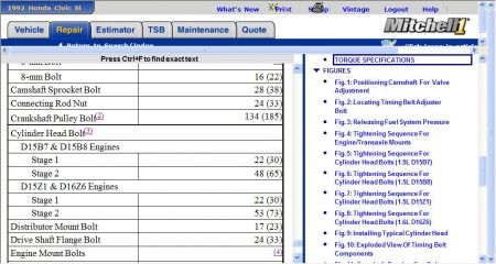

HONDA TECH 1818
  • 536 POSTS
CYLINDER HEAD BOLTS TIGHTENING SEQUENCE
Tighten the cylinder head bolts in two steps.
1st step : 30 N Â m (3.0 kg-m, 22 Ib-ft)
2nd step:
D16Z6, D15Z1 engines:
73 N Â m (7.3 kg-m, 53 Ib-ft)
D15B7, D15B8 engines:
65 N Â m (6.5 kg-m, 47 Ib-ft)
+12

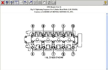

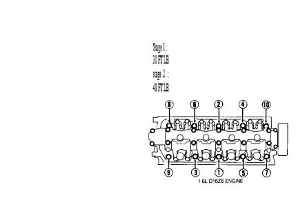

SKITZ
  • 1992 HONDA CIVIC
  • 4 CYL
  • FWD
  • MANUAL
  • 146,000 MILES
I have a 1.6 16v esi v-tech civic here and I have just stripped the head down to fit a new head gasket. The engine has 146,000km on it. I was looking to know what the torque settings are for the bolts on the head and what is the sequence for tightening them?
Thanxs for all your help :)
+2
BMRFIXIT
  • 19,053 POSTS
https://www.2carpros.com/forum/automotive_pictures/99387_honda16_1.jpg
https://www.2carpros.com/forum/automotive_pictures/99387_honda_16_1.jpg
+1
  • 75,992 POSTS
See below
https://www.2carpros.com/forum/automotive_pictures/12900_head1_1.jpg
D16ZE stage 1 22ft lbs /stage 2 53ft lbs see below
https://www.2carpros.com/forum/automotive_pictures/12900_head2_1.jpg
