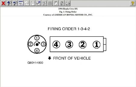

how are the cyl. numbered on 94 civic dx 1.5. i believe 1 is by the pulley what about 2 3 4 ?

Here you go sir
https://images.2carpros.com/forum/automotive_pictures/12900_fo_28.jpg
