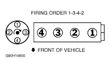

1994 Honda Civic Correct placement of spark plug wires
300,000 MILES • 4 CYL • FWD • AUTOMATIC
HJONES21
I left my car with someone and the rearranged my spark plug wires. I need help srtting them up correctly.
Aug 31, 2010 at 9:54 AM
BLUELIGHTNIN6
  • 16,542 POSTS
https://images.2carpros.com/forum/automotive_pictures/261618_Graphic_672.jpg
