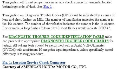

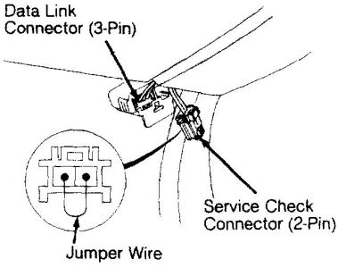

Your car should idle at about 650 rpm. No need to go for expensive diagnostic fee. Here is to check your codes using your DTC. Paper clip works great as a jumper.
https://images.2carpros.com/forum/automotive_pictures/55316_94hondaobd1_1.jpg
https://images.2carpros.com/forum/automotive_pictures/55316_hondaobd1_1.jpg
Then post the codes here. We'll determine what they are.
