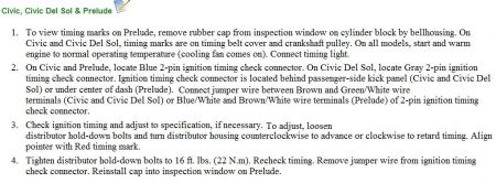

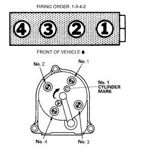

NEED DISTRIBUTOR POSTION AND WHICH SPOT THE #1 PLUG WIRE GOES ON AND IF THE NUMBER 1 CYL IS ON THE LT SIDE OF THE CAR AT THE TIMING BELT.THE CAR SEAMS TO BE RUNNING ONLY ON 2 CYL.
