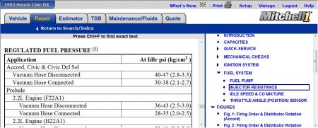

I keep getting advice to check the fuel pressure for a 1993 Honda Civic (manual) but I don't know how or what the pressure should be. Any help?

Hi bassline627 and TY for the donation Get a fuel pressue gauge designed for your fuel system-hook it up on the fuel rail test port or fuel filter start the car record the pressure readings with and w/o the vacuum hose on the pressue regulator See specs below
https://images.2carpros.com/forum/automotive_pictures/12900_fuel_pressure_readiing_1.jpg
