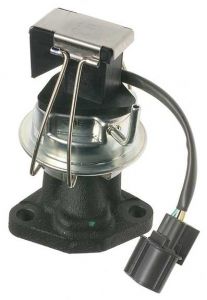

They do sell an EGR valve for it. Some Japanese manufacturers made a FEDERAL engine (no EGR) and a CA. engine (with EGR).
Do you see an EGR?
https://www.2carpros.com/forum/automotive_pictures/108325_honda_EGR_1.jpg

Where on the exaust manifold would I find it? I didn't see one. Also my friends snap-on scanner found (with no check engine light on) a stored code for an over lean condition, fuel pressure regulator. How do you trouble shoot that? The car runs like a top and doesn't knock!

EGR connects exhaust to intake, some are cast into intake manifold.
There should be an emmissions sticker that says "non EGR" or "EGR equipped".
Lean or rich can cause this problem. You would need to start by checking fuel pressure with mechanical gauge.
