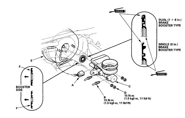

im trying to change my master cylinder do i just unbolt the lines and take out the cylinder and connect the lines to the new master cylinder do i have to use any special tools for any reason and is ther procedure to bleed the brakes ok thanks

Yes, there is a special procedure that needs to be followed or you will have no brake pedal, here is a guide and video to help with instructions below to help you will your car.
https://www.2carpros.com/articles/how-to-replace-a-brake-master-cylinder
and this guide will help you bleed the master before installation.
https://www.youtube.com/watch?v=WDxvEQrMkBg&t=338s
Check out the images (below). Let us know if you need anything else.
