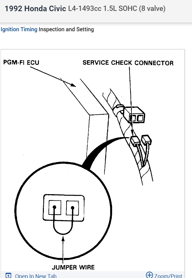

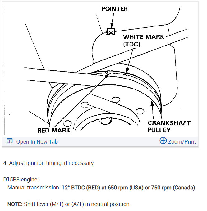

Hello...I am unable to locate the cover / view window on the bell housing for verification of timing mark on crankcase / flywheel...can you help ??

Honda civic timing mark on timing belt cover and front pully. Prelude and accord on fly wheel

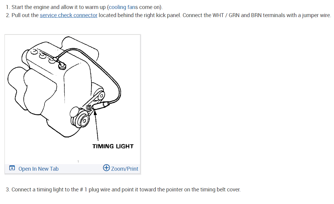

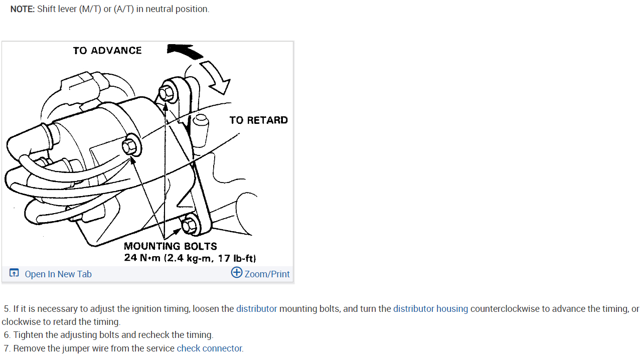

Here are the instruction on how to set the ignition timing and adjust the distributor as well. Check out the images (below). Let us know if you need anything else.
