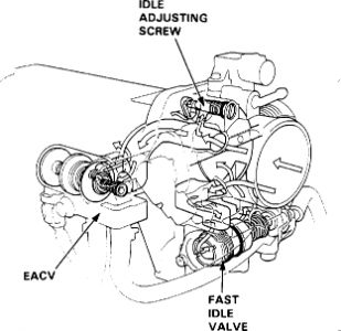

Sometimes my car stalls when I let go of the gas pedal, but only happens with the ac on. When ac is off I dont have that problem thanks in advance.

Soory I forgot to add my car is Honda Civic VX. Engine is 1.5z litter vtec-e. Thanks.

There is an "idle up" valve mounted below the throttle body that is designed to overcome the extra load of the A/C. Check it and see if there is anything obviously wrong with it.
https://www.2carpros.com/forum/automotive_pictures/561653_Idle_up_valve_92_Civic_1.jpg

I found that idle up screw with the diagram you sent me. Do I have to adjust te screw with ac on?

No, I didn't say to adjust anything. The is a valve mounted below that to bring the idle up when the A/C comes on and it likely has a problem.

Ok. Is it called the fast idle valve? If so do I need to take out or how would I know it's damage?

Your really going to need some help. Your probably over your head on diagnosing this.
