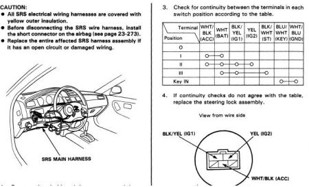

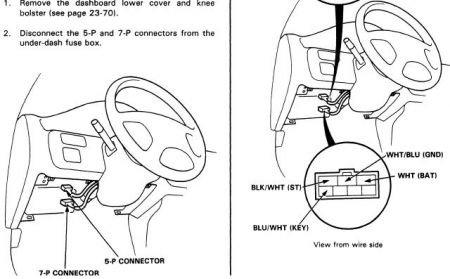

Will a bad ignition switch stop the injectors from getting voltage.
Thursday, March 5th, 2009 AT 10:54 AM
F4I_GUY
MECHANIC
3,302 POSTS
Yes it is possible. Here is how you test your ignition switch.
