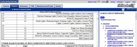

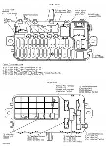

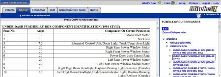

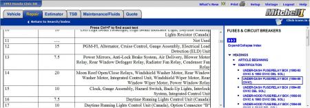

someone stole all the fuses out of the fuseblock under the dash now my fuelpump wont run unless you jumpoer the connection at the main relay. the relay checks out good (according to the method from haynes manual) when you fill all of the fuse locations in the fuser block some things dont work anymore ie:the dome light the chime for the key etc do you have a picture of a fuse panel with the right fuses installed?
