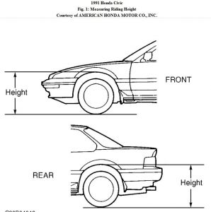

I am looking for the specifications for the stock ride height on a 1991 civic 4 door lx
Mar 23, 2010 at 1:28 PM
KHLOW2008
  • 41,812 POSTS
Hi airic74, Here are the specifications.
https://images.2carpros.com/forum/automotive_pictures/192750_RideHeight91Civic_1.jpg
https://images.2carpros.com/forum/automotive_pictures/192750_RideHeight91CivicFig01_1.jpg
