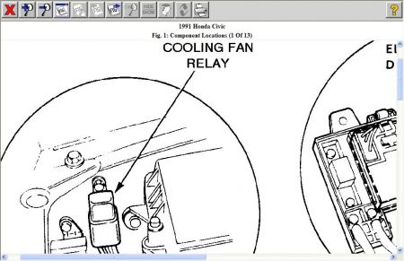

1991 Honda Civic cooling Fan Not Working poperly
150,000 MILES • 4 CYL • FWD • AUTOMATIC
JESUSBRISENO
the cooling fan is not working, but when i turn the a/c on both of them come on, Can u tell me where is the relay and what also can be wrong if changing the relay dosent help. thanks
Dec 14, 2008 at 9:38 PM
  • 75,988 POSTS
Test the coolant temperature sensor and if it has an engine coolant temperature sending gauge/switch check it too. Rel see below Its located at right front corner of engine compartment
https://images.2carpros.com/forum/automotive_pictures/12900_fan_relay_7.jpg
