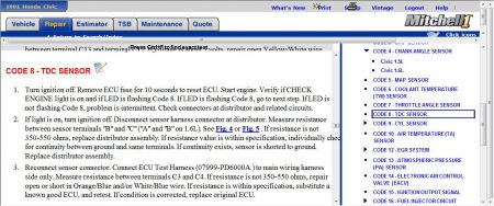

My sons 1991 Civic DX has starting issues. It was running fine, and then one day recently, would not start. I went through a series of repairs and checks and finally got it to start, but it still does not run well.
I am getting an ECU code # 8 (top dead center code).
Do I need to replace the distributor? Is there a potential cheaper fix?

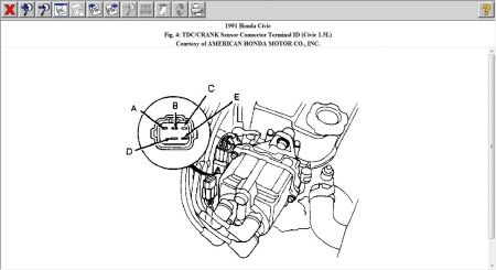

For 1.5 liter engine
Code no. 8 TDC Position Sensor-Problem in TDC sensor circuit
https://www.2carpros.com/forum/automotive_pictures/12900_tdc1_1.jpg
https://www.2carpros.com/forum/automotive_pictures/12900_tdc_sensor_1.jpg
