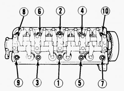

Hey people, some friends of mine just replace a head gasket on this honda civic DX. They've got it all put back together, but we need the torque pressure for the bolts

Two steps, torque in squence shown here.
https://www.2carpros.com/forum/automotive_pictures/62217_ta_1.jpg
https://www.2carpros.com/forum/automotive_pictures/62217_taa_1.jpg
